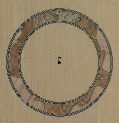

Here are a couple rosettes I just completed. They should look better under finish.
The first is a Michael Collins inspired. I couldn't quite make one with his flare for design but I think it looks pretty good. Thank you Michael It is on a SJ sitka top and will have EIR back & sides

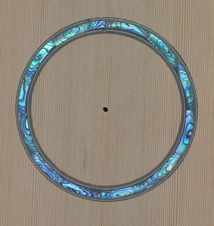

This one is Andy Depauls great paua rosettes. It also should look better under finish. It is a cedar top going on sapele B&S.

I've just spent a couple of hours experimenting to try to find a way to cut those wood rosette rings cleanly- without much success. Obviously you have it figured out!
What technique do you use to cut them ? (type of cutter, etc.)?

Very nice, Joe. Is that abalone 3/8"?

Joe -- nice clean work. The bookmatching of the spalted maple is top drawer.
I've got a bunch of spalted maple and paua -- do you take orders?

I'm always amazed how well-matched is the color of Andy's shell. It just doesn't get much better than that, does it?

It's 1/4", but it does look pretty big in the top. Should show off well.
Steve,
DePaul is great, I ordered a Paua rosette from LMI last year and I'm sorry to say, there is no comparison. (Sorry LMI but please know I do love you. You have made me happy time and again through the years!!!
Anthony....you couldn't afford me by the hour! I spent a lot of time and put a lot of beautiful wood in the trash getting this one!

I starting doing it just like Michael Collins described a month or so ago. I had two problems, my spalded maple was to busy so after all the work bookmatching I might of just as well cut out one piece! The other was I tried to use CA to join the pieces together but the joints showed. The system Michael uses works well if you select your wood well and use LMI white glue...nice joints.
The way I did this one was a little wasteful but it worked. I took an inch and a quarter piece of maple burl, used a circle cutter on my trim router with a down cut end mill and cut an outline of about a 3 inch segment of the rosette. I picked a piece with a nice pattern. I cut about 3/4 way through the board. Then I set my bandsaw at about .1" and cut some slices.
The rosette in the picture is made of about 5 pieces, no set size, I just cut the lenghts I needed to make a nice pattern. I made a jig with the router and circle cutter to trim the pieces to lenght. Kind of like Michaels except I used a rasor saw and not a sanding disk for trimming, Glued with LMI white, inlayed the rosette and the used the router to trim around and make a channel for the purfuring.

If you are talking about cutting the rings I think a lam trimmer is the best tool to use and a downcut bit. Take a tiny tiny tiny cut, plunge a little deeper and cut again. If you are getting chips out of the edges of your ring try taking shallower cuts.
Microfence makes a great tool that is can be modified into a rosette cutter. It gives you .001" accuracy, but it is expensive.
If you use a dremel, just go slow. I really am not a big fan of the dremel, but I use it for rosettes sometimes.

John, take a look through the archives under "circle cutter"
You'll find a couple of home built's that will work very well.
I made on based on Tony Karol's, you can see it here
